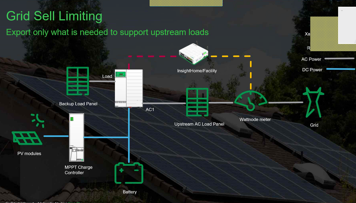

Have read much of the load shaving comments and everyone seems to have an opinion, but have not read one thread where the OP has said it works great.
My inclination is to use batteries almost to the extent of being off grid and changing the batteries from AGM to Lithium. Hoping there are settings that will make the XW6048 load shaving nearly as effective as that of the newer inverters.

Pretty old XW. You could try it. Below is one of the ways that the latest XWP worked for me. They are now obsolete.

Hey Dave, thanks for that, but the implications of the 6048 being too old suggests that I need to look at not only the inverter, but two charge controllers and perhaps the SCP. Are you aware of any Schneider products that replace the inverter almost seamlessly?
Call the store here ! They still sell XWP. Have them walk you thru it. I still bill this for people but they will do it for free! Below is the Insight Cloud that will modernize your system.
htps://offgridsolar1.com/
E-mail offgridsolar@sti.net -
The only equivalent product that NAZ has for the XW Pro is the Conext XW and the fellow I chatted with did not seem real familiar and suggested it was not compatible. BTW the graphic above doesn't seem to have relevance here??Dave Angelini said:Call the store here ! They still sell XWP. Have them walk you thru it. I still bill this for people but they will do it for free! Below is the Insight Cloud that will modernize your system. -
You spoke with the wrong guy! Ask for someone who knows XW! The graph is what you use to see the system. Kind of like the scp BUT a visual method of seeing what is happening. Conext is how XW is marketed for the last 10 years or so.
Your XW gray box is completely compatible with the white box XW pro. The one you have was made from 2006 or so to 2012.
below is a home screen for Insight and a link to Schneider Good luck!
https://www.se.com/us/en/product-range/66297-xw-pro/#overview
