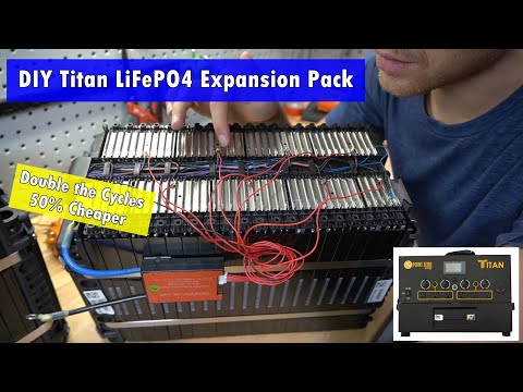

No, the BMS connector appears to be in another post you did titled "Hooking up these lithiums". It's on the left side of the picture.
This video will help you.
https://www.youtube.com/watch?v=pcatgGpdE9o
It's an 8S so I'd probably consider the Overkill Solar 8S 120A BMS as long as my power requirements were low enough . I always go much larger current ratings as it works the BMS less. I've used it, it works reliably, it's not my favorite but it is worlds better than riding those packs bareback like you are......
With the Batrium, Orion and Thunderstruck you need to provide a disconnect. The Overkill has this already. It can switch the battery out of the circuit if there is an event. I don't like mounting this type of BMS as shown in the video above. This type of BMS can fail in a cloud of smoke, heat and possibly flame. Some separation is preferred.
That is about all the help I can offer. Be well, be safe! -
