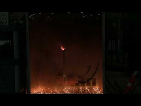

    Next is 48 volt to 240 volt arc flashes:
    https://www.youtube.com/watch?v=1ckk3owZz-w
    And an example of 4x 60 cell (Vmp=30 volt) solar panels in series--And an example of an Arc Fault--Where an electrical connection fails (corrosion, pulled connector, etc.) and starts a sustained arc:
    https://www.youtube.com/watch?v=S9a2oPCIMr0
    In the end, be smart and careful.

    State Farm or most any insurance company is going to want to know the cause of the fire. Just make sure if you do a large battery system in a garage that is close to the house, or part of the house, that they have been informed and it is installed to the local code.
    Offgrid often can't get insurance or it is too expensive. Look at the fire burning now in Mariposa my old home town.
    https://www.youtube.com/watch?v=HsuIJf7AuJQ
