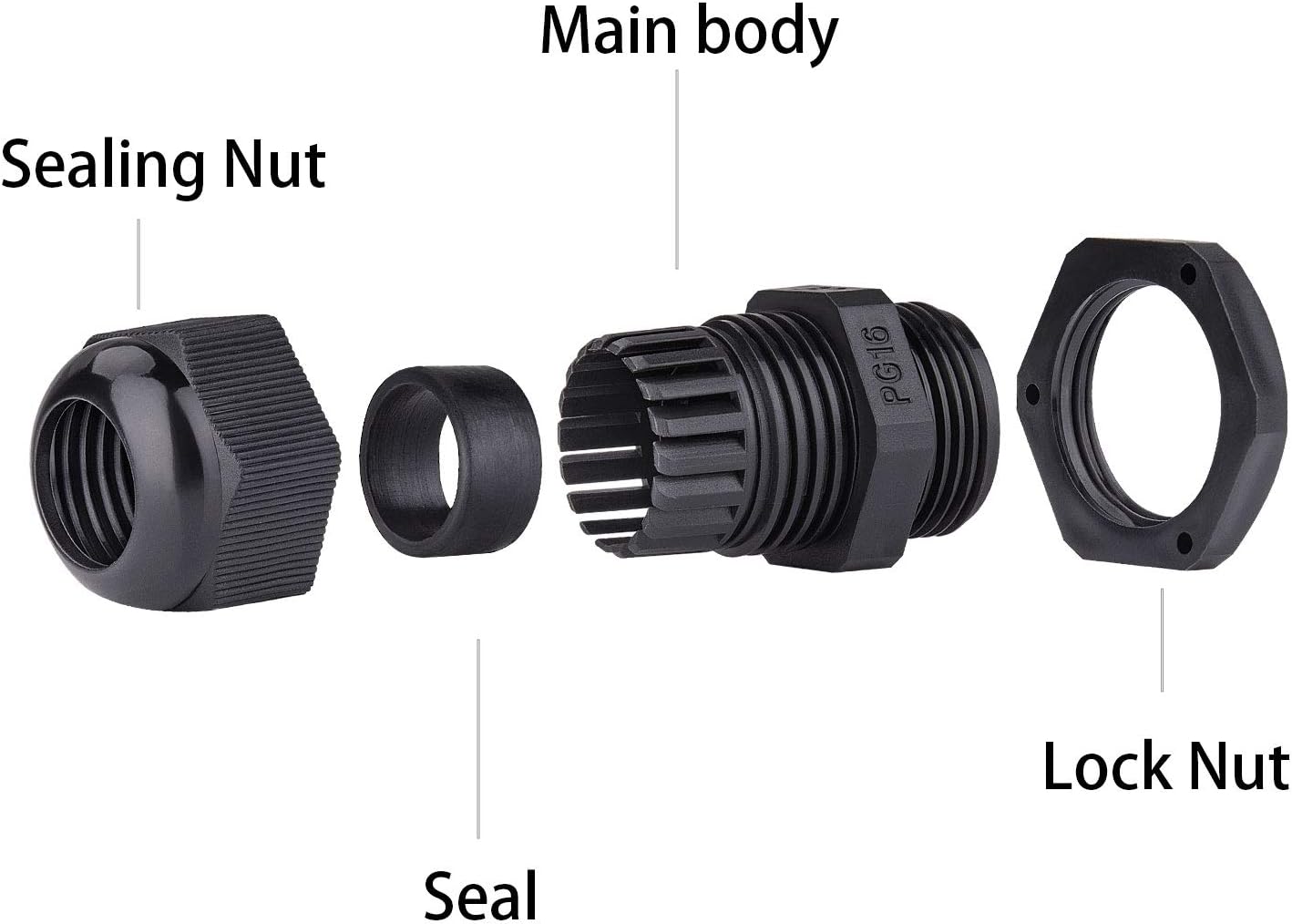

    DesertDweller Registered Users Posts: 16 ✭✭
    Cable Glands! I found out what they are called. They make a waterproof seal around the cable as you tighten the nut. I can use these to bring my solar wires into the house as well. Hopefully these can replace the need to zip tie and tape!
  • wellbuilt
    wellbuilt Solar Expert Posts: 763 ✭✭✭✭
    Nope the wire will crack at the compressing point , it happens all the time . 🤗
