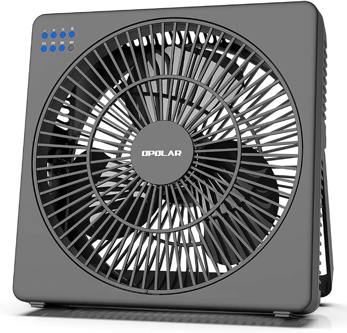

I have 6 volt nominal 40 watt solar shingle, I use to charge a USB power bank. Sunelec.com had some assorted larger 6 volt panels, though I didn't find any on their website.
I built a solar emergency system for my mom in Florida with power bank,, fan.. This small 8" fan puts out pretty good air for the sise.
https://www.amazon.com/OPOLAR-Included-Operated-Operation-Adjustable/dp/B077SDZL88/ref=asc_df_B077SDZL88
Uses 4 watts at full power here's picture for scale next to a l0,000mah power bank and phone;
