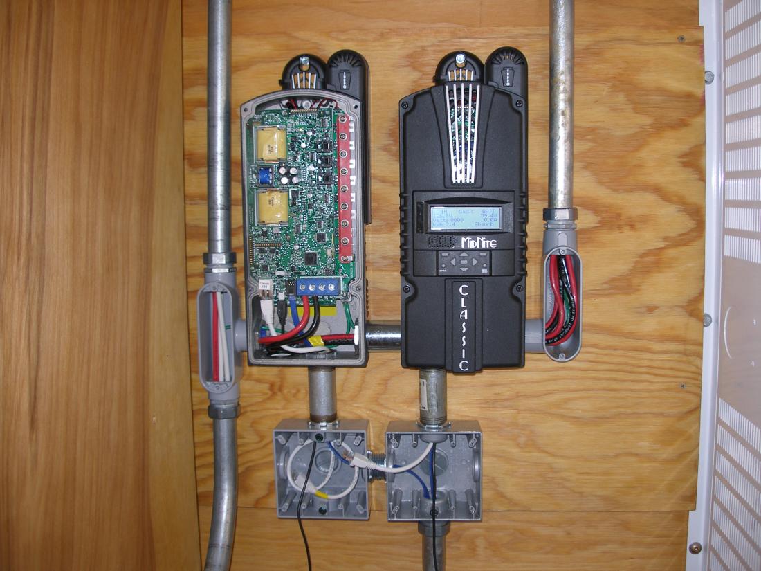

    NO.   Am referring to BB Bill's description  --  wind your own on Ferrite donut cores,  primarily.
    Use Mix 31 material generally for HF.   2.4" OD,   stacked,  several cores high,   and taped together.   KF7P  has a very good selection:
    Info on selection of material is here:
    Also look at K9YC's exhaustive treatise on making ferrite chokes:
    Hope that these links work,   do not like the looks of them.
    Make your own DC common mode chokes,   choose the size of cable that you need.   KF7P  now stocks a huge core 4" OD X 3" ID X  1" high,   but,  you should not need one of that size.
    EDIT ( WOW !!  Edit NOW works on this computer !!  Thanks!)   Also,   look on K9YC's site.   Even info on Transmitting Chokes has great info on how to look at the suppression of common mode currents:
    http://www.audiosystemsgroup.com/K9YC/K9YC-old.htm
    73  GL,   and let us know how you are doing.    Vic

    Ferrite kits are very useful.   Love the Snap Ons,   especially for  cables that have connectors already attached.  That Monster 3" ID core is very useful for large cables on the output of large CCs.
    The following image shows two CM Chokes used on one,  of two CCs.   BTW,  all above ground cables are in EMT (metal) pipe"
    Thanks,   as always,   Vic
