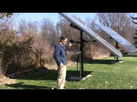

    Well, that's your opinion.  What I can say is that my frames as constructed have already gone through a winter with storms that have knocked down 18" oaks (I just chopped one up last weekend for firewood). They're all in perfect condition with no problems whatsoever.
    I can also add the Missouri Wind and Solar markets a 4" steel pipe frame designed to hold eight 250W panels, so it appears that my design may be too conservative.
    https://www.youtube.com/watch?v=2k5XaPImhK0
    Let's see some pics of your wonderfully overbuild tracker?

    Lots of details that matter in pipe size. Schedule 40? 80? Back/side guys/bracing? Design wind load? Local climate. Length of pipe above pier. Corrosion prevention, especially where the pipe meets concrete pier.
    Conservative can be a good thing. There was an early-ish storm at my cabin this fall, in which a lot of freezing rain and wet snow was followed by much colder temps and high winds. The wind blew the ice-weighted tops off lots of trees large and small, and a few down entirely. Fortunately none hit arrays, and the racking itself held up fine. Not something that happens every year, but often enough to be conservative.
