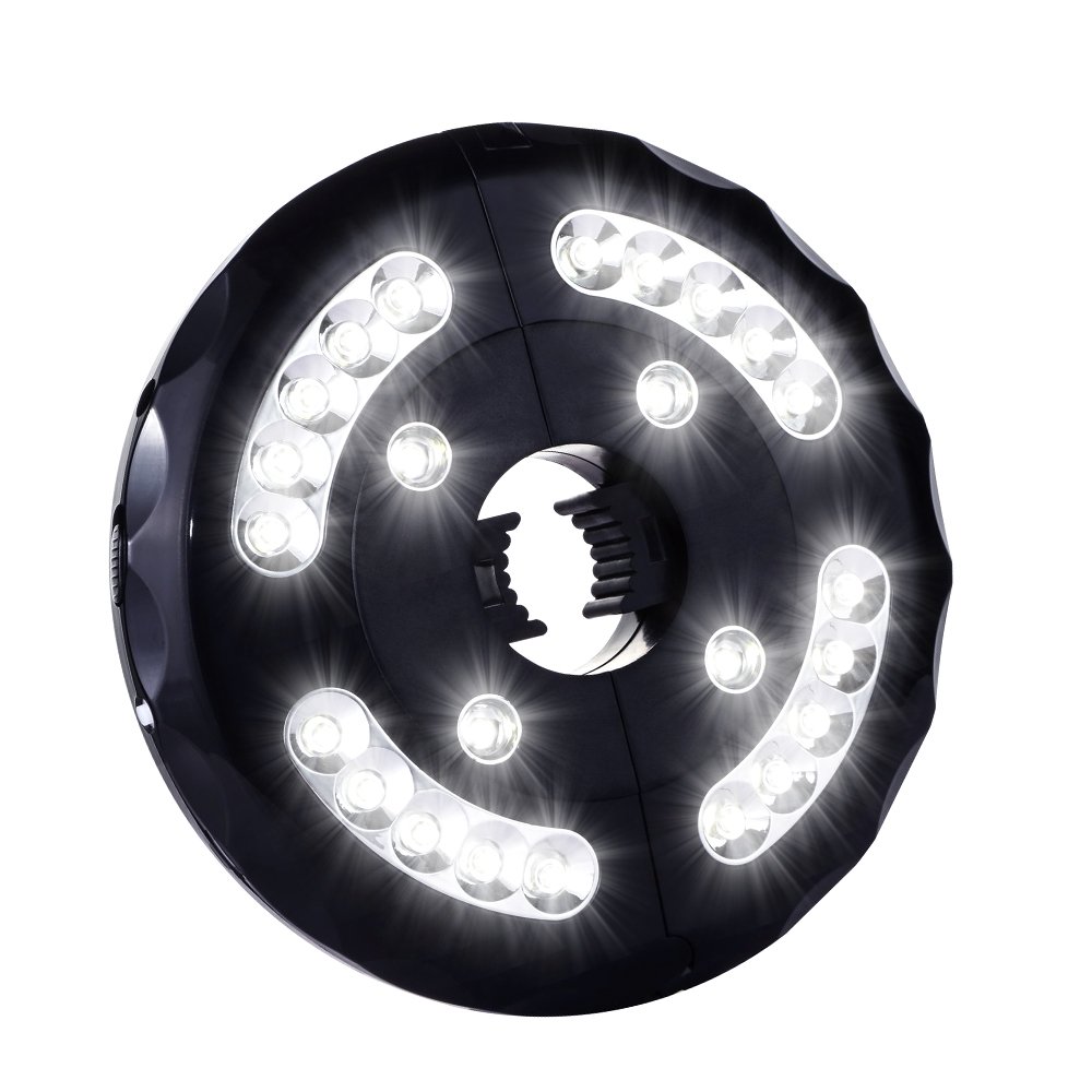

I never wanted a lot of bright light in a cabin personally, but you might be doing some surgery in there for all I know. I have an LED battery powered pole light for an outdoor umbrella that is extremely bright (24 or so leds, 12000 lux) so there are a lot of options in the battery powered arena that will give the same or similar illumination as your 8 watt lamp.
