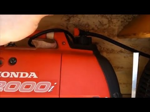

A Honda eu2000i can be a nice backup for you... Uses around 1 gallon of gasoline every 4 to 9 hours (1,600 watt load to 400 watt or less). Also, since they have an internal fuel pump, you can buy/modify a fuel cap and it will siphone fuel from a 5 gallon gas can:
https://www.youtube.com/watch?v=RDkL593Wbt0
https://www.amazon.com/EXTENDED-FUEL-HONDA-Eu2000i-GENERATOR/dp/B004BJ5YKM
Just change the oil every 25 hours (recommended)--Been looking for an external oil sump/filter that could make oil changes less often--but have not seen anything yet).
Of course, need to ensure that don't have fuel leaks (draw fuel, and worry about fire) and you don't get carbon-monoxide into your home.

Those are really nice gennies but I already own a couple Chinese made ones that had me disappointed in changing the oil so often but now that I see Honda's are the same way I guess I should keep quiet about it, as they're not very noisy, were super cheap and so far have been very dependable provided you change plugs and oil almost every time you run them. I also add anti ethanol treatment to the gas I use in them as gasoline comes with crap in it nowadays.
Didn't realize Honda's have a gas pump and again, that's fantastic info to remember next time I need one.
