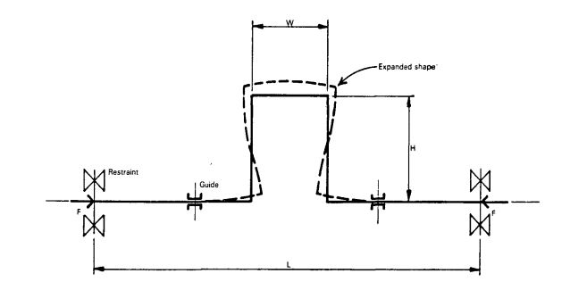

Will there be stress on battery terminals if a 10" copper bus bar goes from 0 F to 100 F? Yes.
How much stress? Well, how much stress can a 0.017" increase in length over 10" cause?
http://www.engineeringtoolbox.com/linear-thermal-expansion-d_1379.html
If you think this is still too much, then maybe an expansion loop as what is used in long piping runs:
Just a thought.

Good information, it's only 2 batteries in a bank x 2 for 870ah so I'll just go with cable instead of the buss. Thanks for all of the guidance!
Actually, I was suggesting that the stress can't be that much... Anyway, cable works great too, that's what I have.
