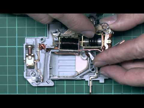

And here is what inside of a typical AC circuit breaker:
