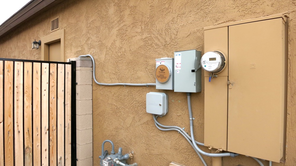

Re: Finally permit plans submitted!
Install started today, they were out here about 4 hours. Got the meter box, disconnect box and inverter mounted and wires ran (gonna need to paint those tubes...not the most finesse looking install but shortest/easiest route I guess).
They also got up on the roof and started prepping for the rails by removes roof tiles and pre drilling holes in the rafters. -
