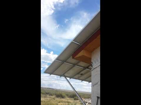

Here is a short video I made the day of the install.
