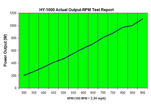

    Mikael,
    Are you referring to this graph on the Windmax site?
    If so, there must be an error in the "100RPM=2.24mph". There is NO way that a small wind turbine like this (not even the HY-3000) would be able to produce 400 watts of power in the 8-10mph range.
    By the way, that graph is posted by Windmax which is not the manufacturer. They are the US based dealer/distributor for HY Energy. Unfortunately, it appears they have made a mistake (hopefully not purposely) in their graph. In the past, when I got information from the HY Energy factory directly, they were very professional and gave me lots of good information (which I found to be accurate).
    In fact, based on the information that HY Energy factory sent me directly, my HY-2000 wind turbine actually produces MORE than the factory graphs show.
    Again, I think the problem with that graph that Windmax posted on their site is the "100RPM = 2.24mph". This can not be true if it means that 8-10mph = 400 watts! Impossible for such a small wind turbine.
    Edward
    PS. I just realized that perhaps that "100RPM = 2.24mph" should really be "100RPM = 2.24 m/s". That would make a lot more sense. Then 8-10 m/s would be 18-22mph. 400W at those speeds for that HY-1000 wind turbine would make sense.
