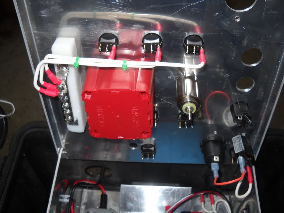

The beginnings of the 'guts' of the control panel:
I am keeping both the AC and the DC grounds isolated. See if you can spot my newbie mistake along those lines in the pictures above and below:
Anyway, the grounds are isolated from the aluminum chassis and from each other. I know there is much to understand about this subject, and I hope to hear opinions. For example: if the inverter is not grounded, what are the concerns? This of course means that a three-prong 110 VAC plug, plugged into the control panel, has an unused ground prong. And the extension cord that plugs into the wall has a grounded prong that doesn't even connect to the inverter...

Re: Wanted to Share an Interesting Project - Looking for Input, Advice, & Feedback
Grounding is a big debate starter.
Normally a pure sine inverter will have the case grounded as well as the negative DC and the neutral AC. But since there is no actual Earth ground for this portable unit, I'd say you'd be better off treating it all as "double insulated" or "floating ground" like a portable generator. Others may disagree.
As for charging batteries in a closed space ... either AGM's or gels should be fine so long as the current isn't too high. Heat dissipation will be a problem for everything, even with the lid open. -
This is a decent shot of the control panel after completion - it is shown removed from the pelican case.
You can see the two analog amp meters, one shows the draw, or power being used. The other shows the power coming into the PUP, via the AC charger, solar controller, or both. This should make it easy to tell if you are running a deficit or a surplus at any moment by comparing in versus out.
The digital display in the middle top is the real-time voltage of the battery.
Anderson power-pole connectors on the left, two binder posts on the opposite right.
Main power off in the center (big rotary switch).
(6) LED switches, - these control the lights, DC chargers, AA chargers, and charging for the LED flashlight.
Two 5-volt USB ports in the middle.
12 VDC 'cigarette' style ports.
All the power points have a 10-amp circuit breaker adjacent. Superior to fuses. More expensive, and more work to install, but real nice when you are having trouble and are flipping a breaker for some reason.
In the middle at the bottom, the two 110 VAC outlets with power switch.
Next photo, chassis removed from case, panel open:
You can see the AGM battery installed. There is very little play between the battery and the chassis... this is deliberate, as the battery is almost 52 pounds, and I don't want it shifting at all if the PUP is being tossed around, dropped, or transported.
The wiring looks a bit messy here, I had some retention clips removed to access other stuff. It is nearly complete though (wiring) in this photo.
BTW, I ran the charger today with the case closed, for about 4 hours. It was in bulk mode the whole time, and ambient outside temps were in the high eighties. Upon opening, the interior was noticeably warmer. at least ten degrees warmer. Not enough to worry me, at this point...
analog meters!i thought those went out years ago. you probably could've put more accurate digital in there for about the same cost and maybe even less. one thing about them you have to be aware of is that you can destroy the meter movement with the kind of jarring you battened down the battery for.
Re: Wanted to Share an Interesting Project - Looking for Input, Advice, & Feedbackanalog meters!
DRAT!!
But I like the old-school meters...
Allright. And this is hard to take back, considering the hole size and shape needed for the analogs.
Dagnabbit. Well, the next one goes digital. This one maybe I could graft in a plate in each opening, and put digital in, but it would look a bit goofy.
Double-drat.
Ah well, okay.
This brings up a related question... what about some of the smart meters (like Dr. Watts, etc.) to replace all the meters? I checked into them, and they seemed to be intended for a single circuit, not a bunch of loads like I have?
Oh, and thanks, Niel. No, really.
Better that this gets caught now, and corrected before I build one for sale... -
A,
I definitely like the case, it is gorgeous. I especially like the fact that you did it in cad first before you did the first build. I guess I am being bias since I work alot in cad as well but for building and civil works. These are my suggestions:
1. In terms of the solar input through the case you can consider using a pair of pigtail custom made MC4 cables going through one water tight strain relief that accommodates a pair of wires similar to this one
2. In terms of the metering, I think you need a battery monitor so that the use can know where he or she is in respect to energy remaining like a gas meter and know as well how much and at what rate they are consuming. One like this is very good and small and does all of that and more. I have bought five recently for about $150 each. It came with all necessary parts (shunt, wires etc) and it is the smallest battery monitor out there now.
3. You may consider an optional upgrade to LifePo batteries if the person wants a 60% reduction of weight in terms of the batteries. There is a treat here on the same lithium batteries where a member was doing something similar to what you have done. Maybe on of the mods can find it and link to it.

Recessing MC4 connectors into the "cigarette lighter" sockets might make it too difficult to attach/detach; they don't come apart easily without The Tool http://www.solar-electric.com/ditoformc4co.html.
You might consider offering other designs too; ones without all the bells-n-whistles like the lights and NiCad chargers. You know: straight forward power pack with AC and DC out. Other companies make these, but they don't seem to put as much thought into the engineering as they do into the marketing. -
Re: Wanted to Share an Interesting Project - Looking for Input, Advice, & FeedbackCariboocoot wrote: »Recessing MC4 connectors into the "cigarette lighter" sockets might make it too difficult to attach/detach; they don't come apart easily without The Tool http://www.solar-electric.com/ditoformc4co.html.
So the question of an ideal connector for the solar panels remains unanswered... maybe what I have is allright. It is supposed to be watertight, anyway... I just wish that the end user did not have to strip wires and make their own connections if they expand the solar panels...
I like the suggestion about a stripped down version... it would certainly be cheaper and a lot easier to build! What I set out to build was a sort of electrical swiss-army knife. It is what I would want if things went dark and scary and we wanted some secure, portable power that was flexible.
All the input is great, folks! -
If you wanted to install a recessed MC4 socket & plug, the bottom section
screws together and could be mounted on thin sheet metal. (At the bottom of your connector cup).
As for the locking feature, I don't think that would really be required in this app.
Cut off those spear barbs. And open up the outside strap, on the slots. (barbed spear receivers)
Then your rig would be able to easily accept PV power and unplug without tools.
Because this type of connector will be damaged if plugged or unplugged while under power,
I recommend that Velcro straps or some other method be used to secure the PV panel's connector to the case. -
Interesting, Xringer... I see what you are layin' down!
One concern is you say 'thin sheet metal' I will have to see if there is enough engagement between the cup and thread to allow for the 0.140" or so thickness of the pelican case. I also want enough room for gasket(s) and/or silicone.
This makes me wonder about a recessed box, like a 110 vac outlet for the outside of your house? The type that has a hinged, gasketed lid? What if I installed one of those, and then had a pigtail MC4 within? You could open the door, remove maybe 4" or so of pigtail, and have an MC4 that was unmolested and factory original? Might make it hard to easily connect and disconnect, though... I would like to avoid any specialty tools. They have a habit of going gone on you when you need them! -
I would LOVE to reduce the weight. I made trade-offs (of course) on weight versus capacity. I have not weighed the whole unit yet, but it is at least 80 pounds. The case handles it well, but it is hard to move if you cannot use the wheels. With the wheels and the retractable handle, on a decent surface, it is sweet. Carrying it from the house 200 feet to the shop is a pain. I do not want to wheel it across the grass and dirty things up, so I do a one-handed grunting carry.
I need to find pricing on a comparable LifePo battery... so far I am thinking they are at least 3-4 times the cost? Very nice, for sure. The weight savings would be worth the cost if you were humping this thing overland, for sure!
Az
The advantages of the LiFePo battery go beyond simply weight. They will last probably twice as long as lead, AND the gigantic advantage is that they can be deeply cycled, where the lead battery really must be only cycled to 50% for any lifespan.
There are lithium cells advertised for $1.075/ah, for 3.3V, which is an extremely good price. Of course, you'll have to add shipping too. They are for sale here: http://www.alliancerenewableenergy.com/Thunder-Sky-LiFeYPO4-Batteries_c3.htm Also, to clarify, I have no affiliation with this company, and I have never ordered anything from them, nor have I heard of anybody who has ordered anything from them.
So then you could use 4 batteries of 60 ah, for a cost of $258. That is more than the $173.15 for the 75 ah battery (really 37.5 ah usable though), but with 54 ah usable (90%), the price really starts to look better. You might need a BMS, which would add some to the price, but that is another debate, and with only four cells it might be possible to skip. You could drop down to the 40 ah batteries, which would be a less money, but then you would not have the absolute emergency reserve of your chosen lead battery. -
Re: Wanted to Share an Interesting Project - Looking for Input, Advice, & FeedbackInteresting, Xringer... I see what you are layin' down!
The strain relief shell needs to be screwed down tightly, to compress the
rubber doughnut down on the wire. (To be watertight).
But, since those cables aren't going to be yanked on (inside the casing),
the shell/nut should work.. If the metal isn't too thick.
If you install a big pigtail(4") cup, you should go ahead and hack the MC4s
so they don't latch.
At least one of the connectors can be of the Finger-Release type.
(The bottom connector. Squeeze the tabs and unplug it. :cool:
$2.99 Ebay item 320594843356 -
Re: Wanted to Share an Interesting Project - Looking for Input, Advice, & Feedbacksub3marathonman wrote: »The advantages of the LiFePo battery go beyond simply weight. They will last probably twice as long as lead, AND the gigantic advantage is that they can be deeply cycled, where the lead battery really must be only cycled to 50% for any lifespan.
Excellent info! Okay, so the batteries alone are not prohibitively expensive:
LiFePo, 54 usable AH, equals $4.77 / AH
AGM, 37.5 usable AH, equals $4.61 / AH
And the weight!!:
LiFePo, 5.51 lbs x (4) cells = 22.4 lbs
AGM, 52 lbs
And the size!!:
LiFePo: 8.5" x 2.4" x 4.5" or a bank of approx 8.5" x 10" x 4.5", or 383 cu in.
AGM: 10.2" x 6.6" x 8.3" or 559 cu in.
That is all awesome until you confront the BMS. Do you really need a $200+ Battery Mgmt. System? If so, OUCH. If not, then COME TO POPPA!
Oh, and shipping is an issue... 6-8 weeks on a boat? ummm, okay...
But the specs are simply fantastic.
NICE. -
On the MC4 tool, just attach it inside the case with a lightweight chain, heavy string or lightweight steel rope - permanently attached to the tool and case. Secure it inside by bundling it up with a small velcro strap like you have on your AA battery charger. Then you can use stock MC4s and be sure the tool is always there. I like the idea of sticking with MC4s so you can use off-the shelf PV.
Thinking outside of the box - literally - I would suggest you divide up the project into 2 smaller boxes. One with all of the output electronics/connections, the other for the battery and both chargers. Easier to lug around in 2 parts, ability to just take the battery box outside for solar charging or to attach to a neighbor's genset 3 houses away, ability to easily add (sell) modular battery capacity.
The last is a biggie, its the one achilies heel to the whole thing with only 52 amps available at 70% depth of discharge (70% is reasonable for an emergency power system, where power NOW is more important than long-term battery life). You sell them one battery box now, then your customer realizes they need 3 times as much run time so you sell them 2 more battery boxes. All they have to do is plug them into each other in a chain which internally you have wired in parallel. Which leads to one more selling advantage, you could offer more than one battery chemistry to the same user without duplicating the output electronics. Just provide more than one input on the "main" box with different connectors for each chemistry and isolate them electrically so they can't back-feed the others. With the chargers already in the battery boxes you just match the charger and battery at the factory, the user just daisy-chains like chemistries as needed.
Someone already mentioned lithium, there is also flooded NiCad which has several advantages over lead acid. Yes there is the issue of keeping them upright but since the battery cases would be separate you could clearly mark them "this end up at all times". Flooded NiCad is lighter, can be completely drained to 100% DOD (and stored that way!), lasts up to 5 times longer than lead acid, doesn't loose much capacity when cold, and its compatible with lead-acid chargers if necessary. Here is one manufacturer: http://www.sbsbattery.com/subpage_index.php?_subp_=1424.5 kw APC UPS powered by a Prius, 12 kw Generac, Honda EU3000is -
Re: Wanted to Share an Interesting Project - Looking for Input, Advice, & FeedbackExcellent info! Okay, so the batteries alone are not prohibitively expensive:
NICE.
OK, I thought the website said the batteries were in stock and ready to be shipped. But I don't know definitely.
The BMS is really the debatable aspect. Here is somebody who, while somewhat controversial, states that no BMS is needed: http://jackrickard.blogspot.com/ . Of course, the people that make the BMS say he's crazy. Now, many of these projects use 80 or 100 batteries. With 4 batteries I don't know that a BMS is really necessary. You only have to make sure that no battery gets overcharged or undercharged. So you could possibly be safe with the 90% full and never discharged under 10%, and just occasionally checking individual cells if there's only four.
One person had a BMS for PbA batteries that essentially equaled the cost of the batteries! I never saw how that could possibly be worthwhile. Even when you calculate that you can use a BMS with another set of batteries years later when the first set dies.
