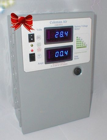

    I have a wind/solar setup working well down here in Baja, Mexico. I use several heating elements as my diversion load and I agree that you should oversize the dump = 3X rated turbine output wired in parallel so that in case one fails you still will have a big dump load available. I also suggest you install a good turbine braking system where you can stop the turbine for maintenance and repair as well as consider fuses and lightning protection.
    I am using a ColemanAir diversion / charge controller and really like the performance as well as easy wiring setup. It is a hybrid and can handle solar panels as well although I prefer to use a Xantrex MPPT for my panels.
    Coleman Air C440-HVA Diversion / Charge Controller
