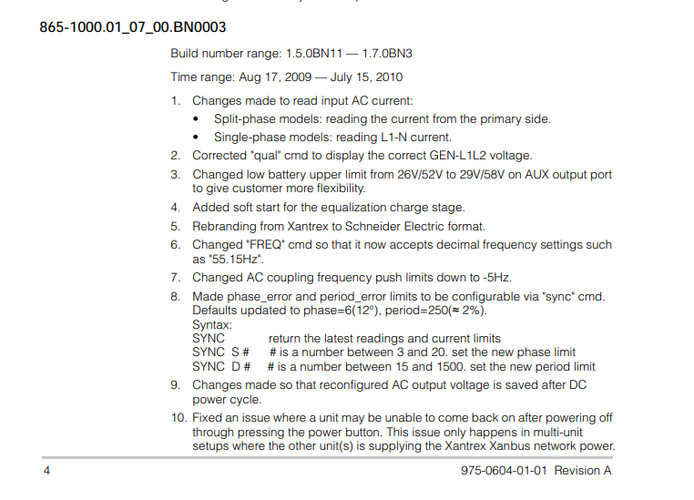

    Original XW6048 with two MMPT-60 controllers  with version 1.07.10 BN 3 firmware
  • Dave Angelini
    Dave Angelini Solar Expert Posts: 7,119 ✭✭✭✭✭✭
    Below are the last release notes for XW greybox. On number 3, are you in the limits? What does Discover say and which model?

    The setting that appears to be the most like the above number three reference is "Low Batt Cut Out".  Discover Energy Systems has designated that setting for their rack mounted AES batteries as 48V.
