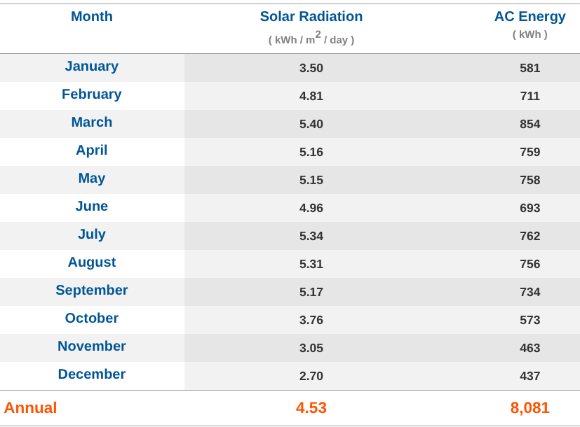

Just to look at a very rough off grid (I.e., battery based) system, 10,000 Watt array, 45 degree tilt, assume 55% average system efficiency, Bangor Maine, will (on average) produce:
https://pvwatts.nrel.gov/pvwatts.php
400-900 kWH per month is not a large amount of harvest from a 10,000 Watt (open field) array...
If you go full off grid, then over-sizing the array/battery bank, etc. to allow for storms and minimize Genset usage is pretty typical (I.e., array should be ~2x larger to support multiple days of bad weather, larger battery bank, and such to minimize Genset usage).
