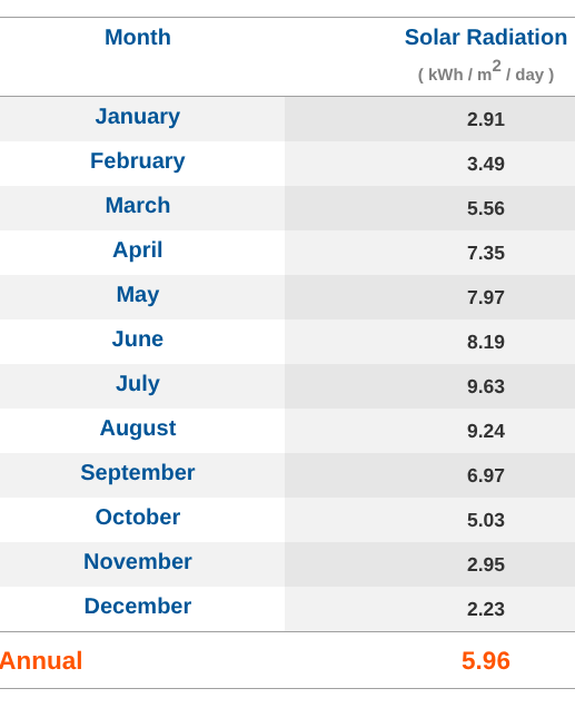

Looking at harvest using PV Watts for Bucharest Romania and 45 degree panel tilt:
https://pvwatts.nrel.gov/pvwatts.php
Between July and December, your harvest is 3.5 more in in summer, vs dead of winter (not even accounting for low sun angle, shading from trees, snow on array, etc.).
Just for fun, same setup except now full 2 axis tracking:
Can dramatically increase harvest--But still poor harvest for December (I suggest that any sun less than ~3 hours of harvest per day is "not great" for solar).
