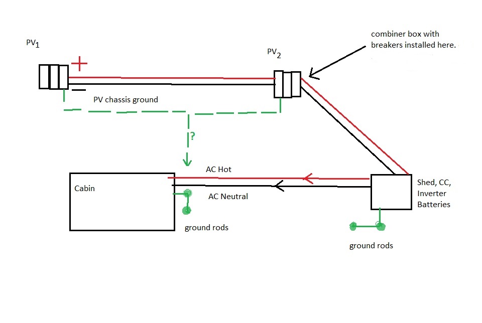

    Hello again, ,
    I've been doing a bunch of reading on grounding and bonding on this site as well as others. It's not completely
    clear to me what I need to do. The attached diagram shows what I have so far. The cabin and shed are built, and there are ground rods
    driven at the locations indicated.
    1) Do I need to connect the sets of ground rods together ? They're about 30 feet apart
    2) PV1 is ~ 80 feet from the ground rods near the cabin, is the dashed green line the proper path to take to ground the panels?
    3) The AC load center in the shed is currently connected to the ground rods near the shed and the cabin's AC sub panel is connected
    to the ground rods near the cabin. If the answer to #1 is yes, have I created a "ground loop"? If so how do I correct it.
    4) Have read several times that bonding neutral to ground should occur in only one place, given my diagram, where should this be done?
    really appreciate your help
    Mark

    I would highly suggest that all of the ground rods be tie together.
    There are two major reasons for ground. The first is to provide a current path from "remote loads" back to the power source/power shed.
    So, in your case, the power shed to the home ground rods need to be tied together. The ground rod itself, can have 25 Ohms resistance to earth. At 120 VAC, that is less than 5 amps of current (V=I*R; I=V/R) and not enough to trip your 15 amp (minimum) power supply breakers) if there is a short from "AC Hot" to grounded metal at the home. Running a minimum 6 AWG cable between the two ground rods (power shed and home) provides that reliable safety ground current path.
    The other (major) reason is lightning. You want anything metal+electrical to be earth grounded with a short and direct connection to the ground rod. Again, I suggest 6 AWG cable minimum. Note that lightning is not DC current (it is "radio frequency") and short runs/rounded corners, and there is special woven lightning cables, are used to get the lightning energy to earth, and not flow through your other electrical connections. (higher frequency AC and radio frequency energy/current has a whole different set of rules it follows for wiring/best conduction paths).
