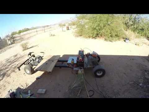

Hey! I've made a MPPT charge controller 4 years ago, and a few weeks ago modified it for my "ev" using our 5.6kW off grid solar array. It's been running 24/7 for the last 4 years (not charging much at night. haha). I have since changed the panel wiring to be 400vDC in. The EV is only 93vDC, but is just a test bed for my Nissan Leaf motor/diy controller. The batteries are A123, from a Spark EV. I have a video of it on youtube. My son and I did it around Christmas time, and we were playing around with the different recording speeds, so sometimes we sound a little like Alvin and the Chipmunks:
https://www.youtube.com/watch?v=dxp8kX_golA
I'll PM you. My layout and wiring skills have improved in 4 years, so don't get too scared. haha.
The spread spectrum switching was really just an experiment, so I had intentionally had the switching frequency in the 9-13KHz range, since I also do high power DC motor controllers in the 400kW range, and you need to switch them sort of slow (like 8kHz) since there are really big IGBTs, so I figured I'd work out the hiss that people would hear while driving rather than an 8kHz "stab yourself in the eyeball with a fork" frequency. That way it blends in with the wind outside. But in the case of an MPPT, it's probably better to switch above audible frequency. -

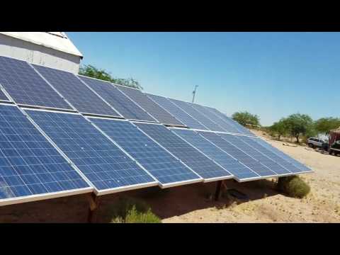

It's basically done now. I ran my mill with it. Both with a soft start where it ramps up voltage at whatever rate you want, as well as just hard turning on. The mill used to always trip my breaker, since it's a big AC motor with a big startup surge. I had left off the AC voltage monitoring, figuring that I could just infer the output voltage from the DC input and phase currents, but it was a little more variable than I would like, so I just did a board today that will monitor all 3 line voltages (Neutral probably won't be very interesting to monitor haha). With this addition, this will be able to be used as a 3 phase grid tie as well.
Here it is running right from the panels with no batteries:
https://www.youtube.com/watch?v=gSJUYZ178HY&feature=youtu.be
It just sags the panel voltage down toward max power. As long as you don't go over max power it doesn't cause any problems. I've been using it to charge my new wrecked Nissan leaf (only $2950!!), as well as window AC units. I would have just done a grid tie, except that it would have been stupidly expensive to go through the right channels. Also, the batteries don't last very long in that shop.
