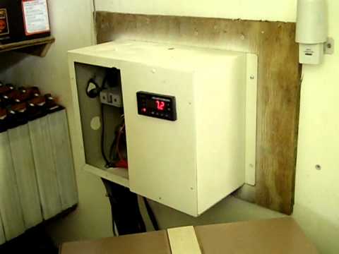

    I have an Eaton/Best 10kW/8kVa online UPS 220/240 1ph uses 120Vdc battery bank. With big enough battery storage extension it can run continuously when other inverters would drop or overheat. 2'x4'x3' @ 185kg (400lbs+) it is made to be run continously under load.
    Hoping to use this as my AC microgrid inverter. Easily a one stop inverter for all my loads. With external battery cabinet (sans batteries currently) and AC transfer switch. Plays nice with all load types and inductive motors. Pure computer grade Sine wave power. But with ~800W overhead. Otherwise I would have to replace it with one or multiple bridged inverters to bank enough watts.
    B.
    Alcatel/Eltek M4NA 48Vdc 8kVa DC power distribution and battery unit. Normally used with DC rectifiers for the telecomm industry but could be reconfigured for Solar/Wind power and DC distribution. 48Vdc is good value for both solar and wind generation. 3'x4'x5' @ 285Kg(600lbs+)
    Hoping to use this as my starter DC microgrid basis and build it out. As configured its all breakered out with a DIN rail, has a sealed neg airflow IP67 enclosure with ventilation and heater, battery shelf and usage monitoring CAN bus controller and temp sensors but sans batteries. Accepts 220/240Vac 1ph grid power like the UPS.
    C.
    I'm still looking for panels, wind turbine, charge conroller, batteries.
    I am considering GC2 208ah 6v as my first battery SLA as these are more forgiving and I'm likely to make mistakes tweeking and configuring as I go. Ruining a set of more expensive SGMA batteries first time out is hard to swallow repeatedly while the lead acid ones can be recovered to use another day.
    This is a video of another Eaton/Best UPS (same unit) in the Virgin Islands that uses a ton of 2Vdc cells to get really long run times and is charged by solar. It was the inspiration to repurpose an older UPS for full time use for my own system.
    https://youtu.be/x7cSiiu8fI4
    I plan to build my AC/DC grid system into a 10' or 20' cargo container and place out back of the house/shop. That way if I ever relocate I can pickup my power system and go.
