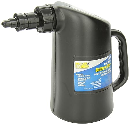

Does anyone have a tried and true method of accurately adding water to their batteries and also maintaining a uniform fluid level in each cell?
It is very difficult to see the level of electrolyte in each cell of my battery bank to determine how much water I need to add. Some cells are just more difficult to inspect than others. I added some water using one of the large squeeze droppers from the auto parts store, which was very difficult to regulate. I'm sure that there is now some difference in the fluid level of the individual cells in my batteries, which I think would skew the specific gravity readings to some extent. The difference is not a large amount, I think, but I can't really measure the fluid levels between. I'm confident, however, that none of the cells is overfilled.
I'm thinking of getting a glass pipette to use to add water. What about a way of measuring the current fluid levels. Does anyone use something like a dipstick? I assume that, like the pipette, the "dipstick" would need to be glass. Perhaps I could use the pipette for both functions if I could add a stop to the glass to index the top of each cell.
Your suggestions are welcome.

I use a battery water filler similar to this one on Amazon, only mine is about 40 years old dating from the times before all automotive batteries became maintenance free.
http://www.amazon.com/Plews-75-030-Capacity-Plastic-Battery/dp/B000RFUF12
Fill the container with distilled water, insert the spout into a cell and push down. Water flows in as air bubbles out. Keep it pressed down against the battery until it stops gurgling. Done!

My batteries are in a garage and I don't worry about spillage too much. I usually fill after my monthly eq when my batteries are the warmest and charged the best as possible. I use a drink bottel untill I have about a quarter of the gallon gone and then use the gallon and try to hit the hole. I wear a head lamp and fill to when it just touches the bottom of the vent tube. I believe this is a tiny bit to much but have never had an overflow. Can't tell the water level if it doesn't touch the vent tube.
I miss a little with the gallon jug but not too bad if carefule. Couldn't do it without the head lamp.

Here's something you may want to look at for accurate watering. It's pricey, but seems to be a solution to this articular problem of proper battery maintainence. I've ordered one to find out. As expensive as a 800Ah battery bank is, this ain't much of an investment.
http://www.flowsystemsusa.com/battery-watering-gun.html

1) They don't hold enough water and are hard to fill.
2) The spout is spring loaded and the flow is started and stopped by pushing it down on the well. There is no way to start or stop the flow unless the well depth happens to exactly the same as the spout length so you'll end up over or under filling the cell because you cannot see into it.
3) The spout length can be to long and when you push into the well and into the plates and bend them and create a short if your not careful. -

Two other things, in general, about these fill bottles;
1. On larger batteries with a large reserve volume and space above the plates, the fill shutoff will happen too late, and the batteries can be over-filled because the tip of the filler does not protrude into the Vent Well (the fill tube of the battery) far enough.
2. And, also on larger batteries the fill rate is SO PAINFULLY SLOW that it can take considerably more than one hour to fill 24 cells -- with about 2 - 2.5 gallons of distilled water.
These jugs are neat, clean, and usually only dribble a couple of drops here and there, they keep the water (inside) clean between uses, and so on, but are quite time-consuming to use on larger batteries.
I still use one of these with a modified tip to accommodate batteries that have a maximum fill level about one inch below the standard fill level of the stock bottle. And only use it on the rear row of cells that are farthest to reach and see into well. The other three rows of this single string of batteries are filled by pouring the water into them from a clean cup.
Also, it is a good idea to rinse the tip with distilled water before each use, to remove dust and possible contaminants..

I have the Plews unit. Which appears to be the same as the Ebay and Napa unit. It isn't near as slow as someone implied. Certainly not fast either. It overfills my 8D's by at least a couple tablespoons. With experience, one could likely find a time interval that worked pretty well. I think 10 seconds/cell would have been good.

I've been using these Plews battery fillers for years. Simple, easy to use and inexpensive.
With 64 batteries to top up every 4 months or so, they have been really durable.Ranch Off Grid System & Custom Home: 2 x pair stacked Schneider XW 5548+ Plus inverters (4), 2 x Schneider MPPT 80-600 Charge Controllers, 2 Xanbus AGS Generator Start and Air Extraction System Controllers, 64 Trojan L16 REB 6v 375 AH Flooded Cel Batteries w/Water Miser Caps, 44 x 185 Sharp Solar Panels, Cummins Onan RS20 KW Propane Water Cooled Genset, ICF Custom House Construction, all appliances, Central A/C, 2 x High Efficiency Variable Speed three ton Central A/C 220v compressors, 2 x Propane furnaces, 2 x Variable Speed Air Handlers, 2 x HD WiFi HVAC Zoned System Controllers -
