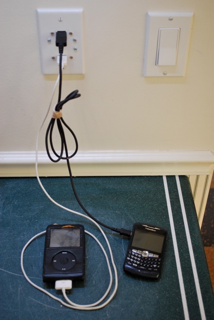

I have built a number of USB charging ports for my cars and a 2-port one connected to my 12 V solar-charged battery bank:
Attachment not found.
Each of these devices use a DC-DC step down switching power supply to provide 5 volts for the USB port. In my testing of various products I have found the Murata Power Systems 78SR-5/2-C to be very efficient and it provides 5 volts at 2 amps. They also make a smaller 1.5 amp one (OKI-78SR-5/1.5-W36-C) that I have used on a different project and it seems to work fine. This one is about a third of the cost ~$4. Mouser sells both of these.
Also you don't need any diodes, just a stable 5v power supply.
We charge all kinds of USB devices including iPhones, iPods, and iPads. I set up the USB port as a universal USB charging device which means the two center (data) pins are tied together. All the iDevices charge fine on these ports, but the iPads limit their charging to 1 amp. You could use the proper resistors on the data pins to let an iPad know that 2 amp are available (if you have 2 amps available).
I didn't look at your solar panel, but you need one that will put out at least about 10 watts to build a useful charger if you are going straight from the sun without charging intermediate batteries. If you are charging batteries, you probably need more solar panel power or more time. -
