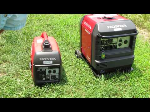

    Epiales wrote: »
    Usually a couple times in a month or two months period. Sometimes it's out for an hour or two, sometimes it's out for 8 hours. We have the worst electric in the world I believe. The wind can blow a tad hard and POOF, we're out of electric. Or no storms, no clouds, no anything, and POOF, we have no electric for 8 hours. So having this happen a few times in a month or two is enough for me to try and do something. I figured it I learned how to do a smaller setup with just some lightening, then I would have a better understanding about solar, and be able to start a bigger project. I know it's not that cheap to setup a system just to run a few 3W lights, but when it's done, it will be worth it in my opinion. Only thing I'll have to worry about after while would be the battery, but using a Lion battery will make a huge difference. With Winter coming up, we will lose our electricity a bit more if we have any ice storms or anything. We always do! Gets on our lines and POOF, no electric lol...
    If the longest you go is 8 hours without power, I wouldn't worry too much about the refrigerator, especially if it is a newer unit. It should hold the temperature, especially if full, for that length of time.
    Honestly, others here may agree, I wouldn't go with solar if you are only going without power a couple of times per month. You should probably be looking at a small generator instead. Although I have never owned one (I haven't taken the time to look for one in my local voltage, 220vac / 50hz), here are some units that are pretty popular. Click here to view Honda Generators.
    I feel you would get more "bang for your buck" if you were to do that. A generator would also run your refrigerator, if you found you were to be without power for a longer period of time. Not to mention, by the time you ever built a solar power system that would provide you with 2,000 or 3,000 continuous watts of power, you would have a lot more money in it than you would a generator. Those little hondas are pretty quiet, to boot. Listen to them when Kenny demonstrates his:
    Paul
