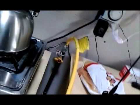

Hi Al, one safety related item, is that heater (water? propane?) vented to the outside?
Looks good.
West Chilcotin, BC, Canada -
Re: Numbers checking way West Texas..
Is your tankless water heater vented outside or into the cabin?
I wonder if your copper wires tarnishing (faster than expected) is from combustion gasses (water heater, possibly cooking if cabin is buttoned up)--Combustion gasses are pretty acidic (water condensation is acidic).
May need some better venting.
If you are soldering your cable ends--Make sure you are using electronic rated solder/fluxes... If you use plumbing solder + acid + fluxes, it will get into the cabling and cause lots of corrosion issues (soldering cabling is something I would suggest avoiding anyway).
The tankless water heater is currently not vented.. nor do I keep the gas valve (on the black pipe) open when I'm not running for max of 3-5 minutes.. everything gets 'closed' on all my gas appliances unless I am running them. I am in town 2 days at a clip as well. and spend my Wed and Sunday at the cabin..
The tankless could/should be vented if I wanted to (and its in my plans to do it)..
I am using the copper Bundy mechanical lug (copper) [BTC0208] on the inverter to bussbar wire ends..
I am using like I said 'old' welding wire (like 300 strand) currently and it seems to tarnish/blackin pretty quickly..
