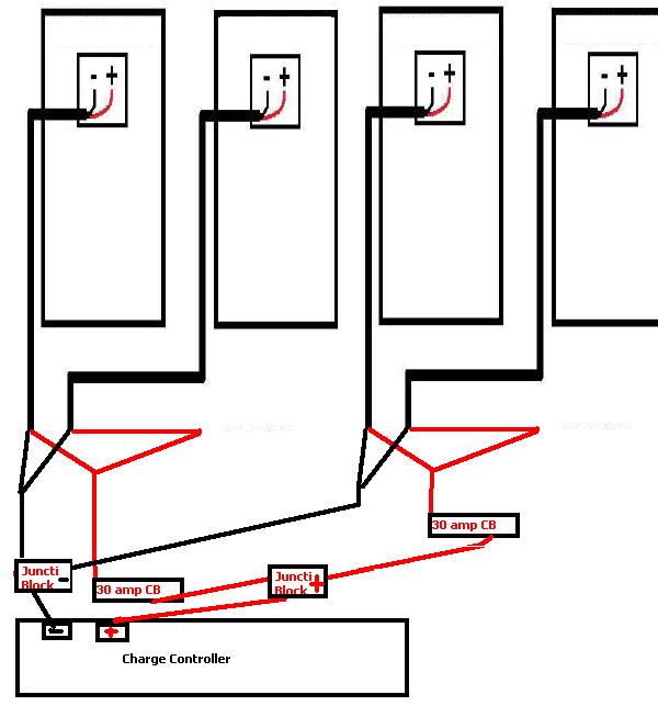

I was going to circuit breaker the 1st parallel set.. and yes a 30' cable 'cut in half' was the plan..
If I add a 2nd 'set' of 2 panels I would repeat and add another breaker for that individual set..
I decided the junction block idea is good for both the + and the - wiring. Like using the mini-box some places sell.. but alot cheaper.

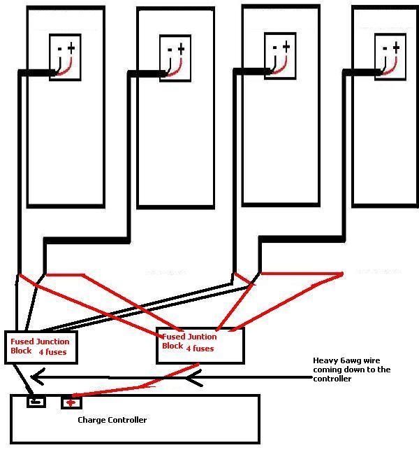

Heres a doodle I did up.. 30 amp breakers on each pair of panels.. (though I can use 20 amp breakers and would be better served).
Re: My 12v Solar Panel Plan.. I would like feedback..
It doesn't matter where the connections are made: if more than two panels are connected in parallel all have to have circuit protection.
I think the OP is considering one array of three on one set of down leads and then adding a duplicate array later. In that case, each group of panels would have one fuse each and each down lead would have its own breaker.
If the arrays were just two panels each, when the second set is added each panel would still have to be fused individually; the circuit protection on the down leads would not protect against three of the panels causing a fire in the fourth should it become shorted. -

One array of 2 panels on one set of down leads.. then duplicate later.. each down lead with a breaker.. -

albert,
this just won't work as you have to have all pvs fused or breakered. picture from your drawing a short occuring in the first pv. immediately you could see the power from the 2nd pv going straight into the 1st one, which by itself would not harm anything. now the 3rd and 4th pvs are not going to trip the breaker going into the 1st and 2nd pvs so it will add to the power already being shorted too so this is ganging up on the 1st pv 3 to 1. -

So I need a breaker/fuse on every line and 4 separate lines coming down to a fused junction block..??

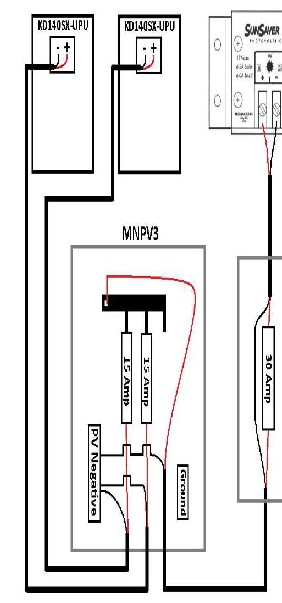

Heres the pic showing 2 panels into a junction box with 15 amp breaker on each panel line, then off to a 30 amp breaker to the controller..
Why then do companies ALLOW and show (and sell) panels to be paralled??
It doesn't make sense.. each 15 amp wire coming down will have its own breaker.. would you suggest maybe a 20 amp FUSE on each leg coming down.. and wouldn't the SEPARATE fuse/breaker on the 2nd array protect from the 1st??
Why do soo many on here say 2 panels on 1 leg coming down is OK, and why do they sell the Y MC4 connectors and the Y MC4 cabling??? -

Would it be better and smarter just to put the fused junction box near (less than 5') the panels (under cover) and come down with just one set of +/- legs of HEAVY wire??
What guage wire should that 1 leg coming down to the controller be?? I'm thinking 6 awg to go 15 foot..
Does this make more logical and safer sense?? -

Please note, while that fused distribution block is covered it is not weather tight. and indeed it is normal/advisable to connect the panels near the array and have a single set of wires going to the CC.Home system 4000 watt (Evergreen) array standing, with 2 Midnite Classic Lites, Midnite E-panel, Magnum MS4024, Prosine 1800(now backup) and Exeltech 1100(former backup...lol), 660 ah 24v Forklift battery(now 10 years old). Off grid for 20 years (if I include 8 months on a bicycle).

It's OK to parallel panels without fuses... as long as there are only two panels (or two series strings of panels).

As Photowhit pointed out it is usual to have your combiner and fuses/breakers very near the panels. Thus the wiring from the panels is fairly short. Once combined you run a single, heavier gauge line down to your controller. The combiner box (with fuses or breakers) needs to be weatherproof or you will have troubles. I suggest that you look at the midnite line of combiners (good prices at NAWS).
Try crunching the numbers... what you save by not buying a weatherproof combiner box may be enough to upgrade your controller to a Rogue or morningstar MPPT (in which case you will not need the combiner).
This whole issue (of fuses) would not be so important if the panels were mounted far away from anything (like your cabin) that could burn. Of course, if the panels were that far away you would be using an MPPT controller for another reason... to save on the wiring costs between the panels and the controller. (another way that MPPT can save money).
One more consideration... The best deals on panels are on those panels with the higher voltages. Of course, to use them you will need an MPPT controller. (still another way that MPPT can save money).
My advice now is to do some more number crunching.
--vtMaps4 X 235watt Samsung, Midnite ePanel, Outback VFX3524 FM60 & mate, 4 Interstate L16, trimetric, Honda eu2000i -

I understand they need to be dry.. but instead of paying $142.xx for the prewired 4 panel Combiner which I'd want because I'm an idiot..
I'd rather buy a single gang NEMA 3R box maybe for $29.. and put my $20 junction/fuse block into it.. or something off the shelf from my local home depot..
I will be starting with 2 panels.. and then do 2 more down the line..
The 3R box with fused junction block will be my best option as then I don't need to play with the wires COMING DOWN to the controller and everything can be done at the box.. I still will be putting a CB on the inside just before the charge controller so I can shut it down for maintenance if needed..
For maintenance on the panels to add more to the junction/fuse block I guess I just pop the fuses out carefully at night??
Or should I get 4 separate 15 amp inline breakers for each panel.. and then get a non-fused juntion panel.. and pack that all inside the 3R NEMA box... <<<may be the smarter option.. -

you should note that only one polarity of the pvs needs to be fused and most opt for the pv+. if you don't opt for solarvic's excellent suggestion then know that you could disconnect all of the pvs after they've been combined and sending it through a switch like this one,

If you go that route, be sure to get DC rated breakers. Be aware that some DC breakers are polarized, and some DC breakers must be in a particular orientation, i.e. they do not work if upside down or on their sides.Or should I get 4 separate 15 amp inline breakers for each panel.
Nobody here would think you're an idiot for buying safe, UL rated, quality equipment. Much of the advice you get here is from folks who learned by experience that buying safe, UL rated, quality equipment is smart and pays off in the long run. If you ever have an electrical fire or liability due to an electrical accident, your insurance company will be able to deny your claim based on your installation not being up to code.I understand they need to be dry.. but instead of paying $142.xx for the prewired 4 panel Combiner which I'd want because I'm an idiot.

So if I go with the baby box its has room for 4 breakers
the downside its not 3R rated..
Now I found a 6 finger breaker bus bar.. http://www.solar-electric.com/mnpv6-bb.html If I only need 4 of the fingers do I just cut off the 2 fingers and the 1 extra main lug?? or just leave it alone??
Would I be better served by buying the ready to go MNPV3 Combiner for $64 which is 3R rated and then just change the 6 bussbar (above) to a 4 holder (6 cut to 4 position).. and put 4 breakers in (2 for now and 2 for later)?? (It has a 6 position negative and 6 position ground bar with it..)
It appears as the DIN flange has room for 4-5 breakers.. I'd only need 4 positions for this setup..

What would be the correct amperage BREAKER to use on panels that are rated at 7.84 amps each??
Would I still want 15 amp breakers or less?? -

use a 15a breaker for it's 1.25 x 1.25 x isc and round up to nearest commercial value available. i suspect the isc won't be far enough above the imp to put it to 20a, but you can do your own math or read the specs on your pv as they often state the fuse value needed. -

6.46a x 1.56 = 10.09a. normally that should be rounded up, but you can't get too much closer to on the money so i'd use a 10a fuse. -
So I can run 10 amp breakers for the 100 watt Grape.. and the same for the 100 Solar Cynergy..
I just read the Grape 100 watt spec sheet. 5.42amp max current out and 6.29 amp short circuit.. = 9.81 amp..
If I push up to 145 watt Solar Cynergy panel at 8.43 amp max current and 9.32 amp short circuit.. = 14.53 amp.. (aka 15 amp).
The Kyocera 145SX is 7.91 max current and 8.68 amp short circuit.. = 13.54 amp (aka 15 amp also)..
So 1.56 x IMP (short circuit) = breaker/fuse size (rounded up)... Thanks niel.. I made a note..
