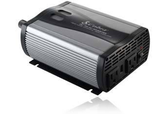

    Cobra CPI 480 400-Watt 12-Volt DC to 120-Volt AC Power Inverter with 5-Volt USB Output

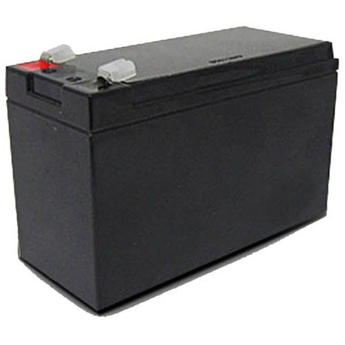

    12 Volt, 7 Ah Sealed Lead Acid Battery with F2 Terminals

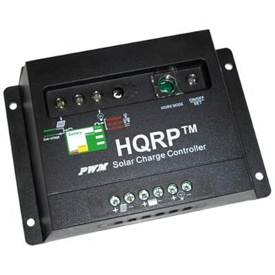

    HQRP 20A Solar Panel Battery Charge Controller / Regulator 12V / 24V 20 Amp 300W with PWM Type of Charging plus HQRP Coaster

    Your 12 volt 7 AH battery:
    • 12 volts * 7 AH = 84 WH of storage (from 100% to dead)

    400 watt AC inverter running at 12 volts, 85% efficiency, at 10.5 volt cutoff:
    • 400 watts * 1/10.5 volts * 1/0.85 eff = 45 amps on a 12 volt battery
    A 7 AH batter would last:
    • 7AH / 45 amps = 0.16 hours = 9.3 minutes
    Realistically, it would probably kill the battery the first time you tried to run the inverter at full 400 watts for over 5 minutes.

    Well three 60 Watt bulbs is 180 Watts. Certainly a 400 Watt inverter will handle that.
    But a 7 Amp hour battery will only provide about 42 Watt hours at best, not including conversion losses. That means your three lights won't be on for more than about 13 minutes before the battery is completely drained. The inverter's stand-by power consumption will probably knock that figure down to less than 10 minutes.
    You certainly won't need that 20 Amp charge controller for one 20 Watt panel; it will probably put out slightly over 1 Amp under ideal conditions.
