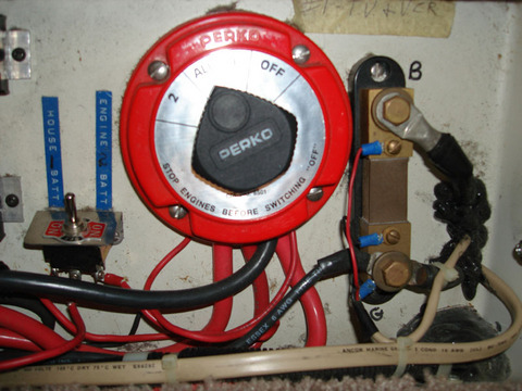

    I did email Nasa Marine and ask them about changing the instruments internal calculation values so I can use the 50mV 400A shunt I already have, but I would guess the answer will be no.
    Here is a photo of the existing shunt:
    Some of the wiring here has already changed.
    Maybe I can find the same brand or one that is close in size so i can use the same space without too much modification.
    Rick

  • mike95490
    Re: Clipper BM-1 Battery Monitor
    What gauge wire do you have feeding that shunt ? Looks like 14 ga romex to me. Say it isn't so.

    The shunt is fed with 2/0 from the battery and various sizes sized for various loads.

    Unless the shunt wires are concealed somewhere, they look like they are coming out of that romex. I'd expect to 2 FAT wires, like going to the battery switches.
  • Cariboocoot
    Mike; the shunt wires are the black ones going to the right, exiting through a hole in the back along with the Romex and a small pair for he meter (looks like thermostat cable). I had to use the big screen to see it.
    But you're right: they do not look like 2/0, which is about 1/2" in diameter with the insulation. Hard to judge from a pic, though. We'll have to take his word for it. Hopefully he knows what he's got. ;)
  • Wanderman
    Wanderman Solar Expert Posts: 180 ✭✭✭
    Mike,
    You need to look closer at the photo. Take a look at the ring terminals you can clearly see 2/0 cable running to the through-hole to the battery. The romex is the shielded wiring to the meters. BTW: it isn't really romex it multi-conductor boat wire from ancor.
    Rick
  • mike95490
    OK OK. I just could not see the fine detail you folks can see, I just see a black blob, and did not realize the big wires went through the bulkhead.
