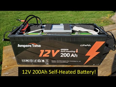

    Just as an FYI--Here is one review that tested capacity (199.3 AH for 200 AH spec'ed battery) and did a tear down on a different battery brand. Pretty interesting:
    https://www.youtube.com/watch?v=MzGN9d0Sb9E
