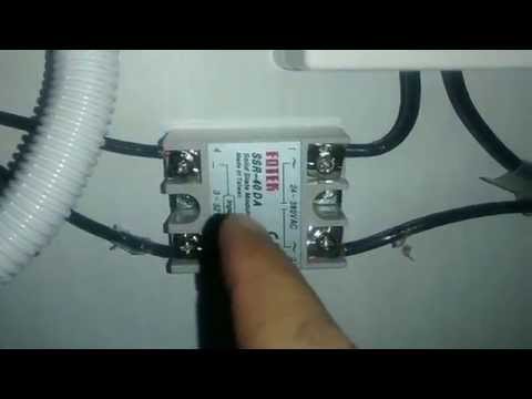

    Thanks guys. I think this post on Youtube might just be the solution I need https://www.youtube.com/watch?v=J0UNfzsa3L0 I ordered for same charge controller and should be getting it tomorrow. If I get a relay I could set a safe LVD from the cc which should protect the battery. I another option is to get one of these http://www.aliexpress.com/store/product/DIN-Rail-Mount-LVD-Low-Voltage-Disconnect-Module-24V-10A-Protect-Battery/316973_32555478335.html .
    Unfortunately Amazon does not ship to my country so am left with shipping via chinese online sites

    Some inverters offer adjustable LVD and remote on/off (try to avoid big relays--those waste power too).
    If you average loads are small, MorningStar has a really nice 300 Watt TSW 12 VDC AC inverter (600 watts for 10 minutes). Can set LVD to 11.5 volts and has a remote on/off input. Plus a "standby" function. Available both in 120 VAC 60 Hz and a 230 VAC 50 Hz model.
    http://www.solar-electric.com/inverters-controllers-accessories/inverters/moin/mosu300wasiw.html
    I don't know if our host ships to Nigera or not (I do not work there, I am just a volunteer on the forum).

    That youtube video... im not sure is a very good guide. Lots of cobbled together cheaper gear there. Be especially wary of those ebay Fotek branded SSRs. They are fakes, and fail horribly. If an SSR costs less than USD50 then its a knockoff.
