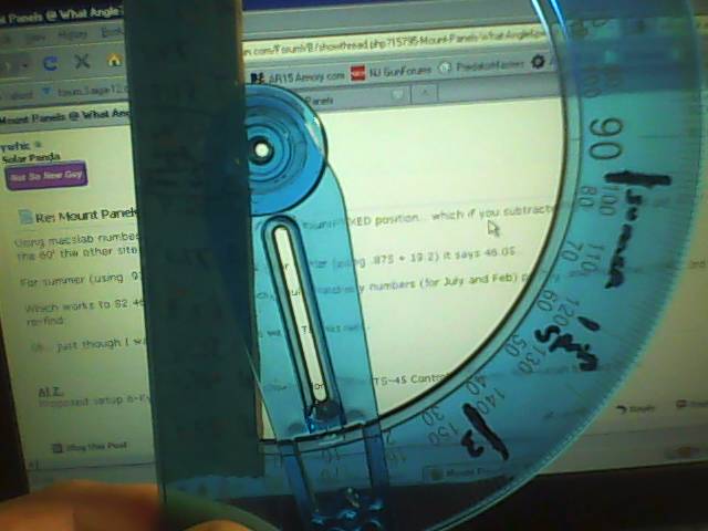

Using macslab numbers I get.. 26.4244 for my all around FIXED position.. which if you subtracted from 90' you'd get 32.57 which is close to the 60' the other site said..
For summer (using .93 - 21) would be 7.54.. for winter (using .875 + 19.2) it says 46.05..
Which works to 82.46 and 43.95 both which would match my numbers (for July and Feb) pretty close from that OTHER 3rd site I still can't re-find..
Ok.. just though I was nuts.. I guess all is well.. Thanks niel..
ETA: heres my TILT protractor that I'm going to use.. Flat side parallel to my pole in the ground.. I marked summer, winter, spring.. and on the back is each month listed in case I get bored.. this would be my 90' as on the post.. so 86' would be almost flat.. -
