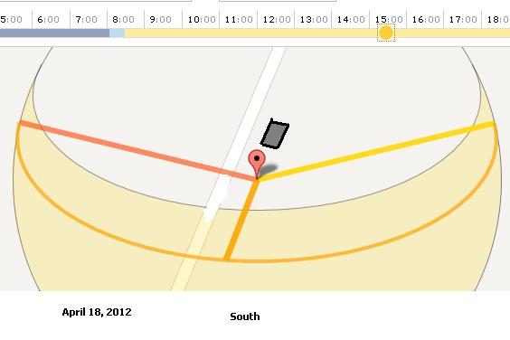

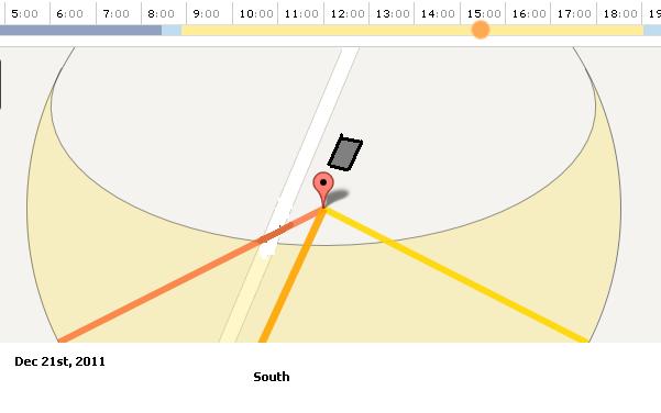

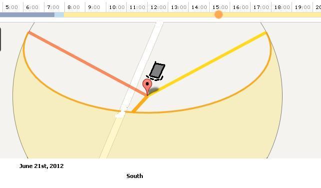

I've used Sun Calc and got spring, summer, and winter.. but I am trying to prefigure where to face my panels..
Winter 9am the sun is South East (like 4:30pm per se) 5pm (is like 10pm per se)
Summer 9am is North East (like 1pm per se) 5pm (is like 8:30 per se)
Spring 9am is East (like 3:30pm per se) 5pm (is like 7pm per se)

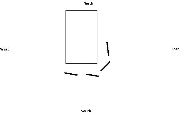

Heres what i came up with last night and before I read the post this morning..
If I turn the bottom 2 190w's more south.. I can get 877 watts (based on the 77% eff number) back into the bank by 5-5:30 pm..
Picture # 2 (just did)
The 2 190's on the EAST side would pick up the same 877 watts in the AM hours..
My angles are Spring 60', Summer 85', Winter 36'.. so yup I have almost a 50' angle change on my panels..
I wouldn't try to get A/C up and going till I got my 440ah bank put into play.. so 110 ah would be the 'draw' for 2 hours.. -

A little semantics. Amp hours are not draws, they're a fixed amount of energy (@ Voltage = Watt hours). For off-setting loads the panels need to produce the same amount (or more) of Watts as are being used in the system at that time. You can only use stored and replace Watt hours calculations where you have averaged the usage and recharging over time. In essence you're trying to plan load-shifting in advance, rather than figuring a way to make use of any 'surplus' which might be available.
If at all possible, try to figure a way to make your panels easily movable through the daily sun arc. You might not be able to determine which direction works best for your usage in advance. In never hurts to have some flexibility in that. From the looks of your diagram, the classic "solar South" direction appears to be best for you. Oddly, that's around your 2 P.M. Summer mark. I find that coincidence suspicious. :roll: -

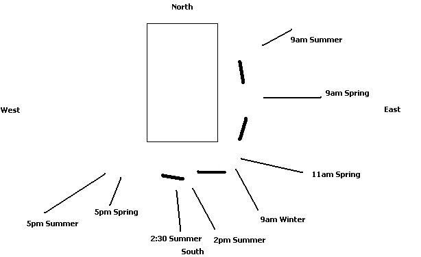

Heres the latest drawing based on a more solar south setup.. and 1 panel hanging East for the morning rise.. -
Re: Sun trajectory and my panel positions..
If you put your panels facing each in a different direction you may not have enough current to do a good, quick battery charge.
Another reason for flexibility in mounting. -

Heres snap shots of my road and my cabin on the SC.. April 18th (when I was there), June 21st (summer), Dec 21st (winter)
My proposed layout E in the SUMMER.. Time with Orange is still 3:30pm.. -

After reviewing some other threads and having a lightbulb go on.. :roll: I'll situate the panels to be from 11 am to 5 pm for sunlight.. then use some of the incoming wattage to offset the A/C usage.. even if I cut the AH draw from the battery bank in half I'd be happy.. better than killing the battery bank alone..
The layout plan F (below) would be it I think (again posts/mounts will be directional and angle adjustable)...
