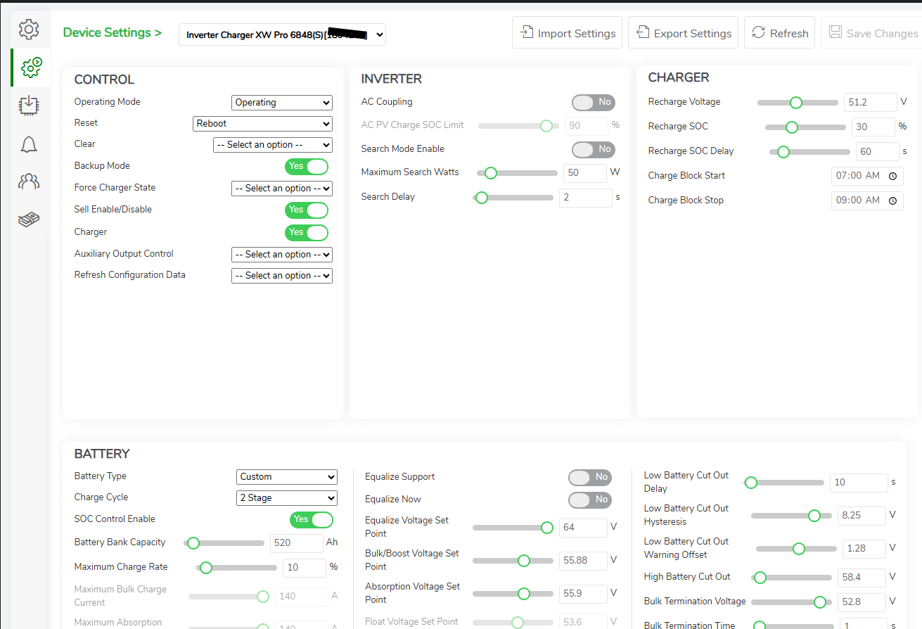

EG4 should be guiding you on how to set this up! What firmware is XWP ?
Screen below is 2 xwp selling set-up with AES batts.
