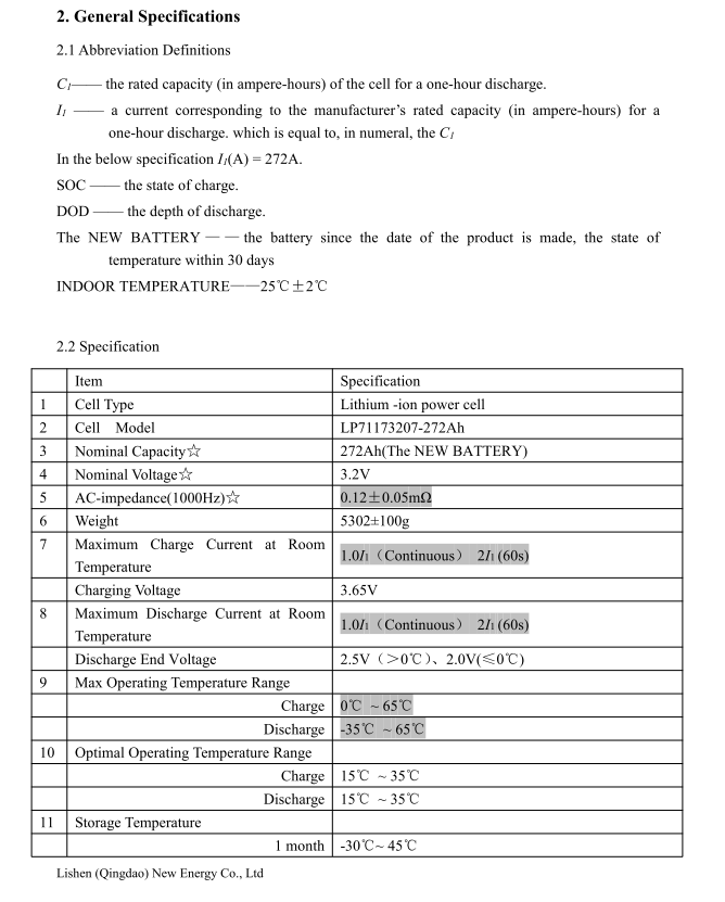

I'm asking this again because I don't have a real understanding between the job of the charge controller and then the job of the BMS.
I'm going to break them apart and treat each component as a seperate device.

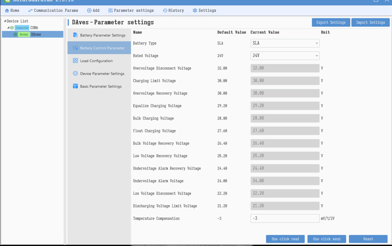

I want to charge my 24 volt battery system to the maximum it can take to get the most out of each cell. (even at the expense of the cells life)
To charge the string can anyone suggest the best settings to charge a string of eight (8) cells to 28.4 volts max? ( Lishen LP71173297 Cells - 272Ah 3.2vdc )
The charge controller is an EPEVER Tracer 4215 BN and I have sent a message to them asking the same question.
Cheers'
Dave
Any help is greatly appreciated!
