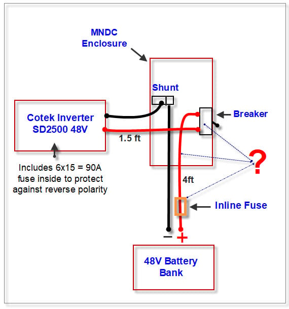

As my trip is approaching, I would like to complete my equipment purchases. Would the following be acceptable choices?
100 Amps Panel breaker - 100 Amps in line fuse near the battery - #2 Awg Battery/inverter cable
125 Amps Panel breaker - 125 Amps in line fuse near the battery - #1 Awg Battery/inverter cable
I have attached a picture of the inverter wiring.
