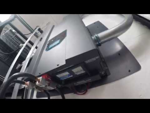

Sigineer (chinese) 12KW Power Inverter:
https://www.youtube.com/watch?v=Hc6KyXbWTcU
I am running 100% off the grid, and have built my setup into a shipping container.
I have 27 210 watt panels, two outback FM80's, 16 group 8D (12 volt, 255AH/ea), running at 48V into a 12KW inverter. Two Honda EU2000I and one EU3000I to run the battery charger on cloudy days.
Mate3 & Hub10
Hoping one day to get the flexnet.....
My cost: $16,000 for the whole entire setup - Wiring, components, panels, shipping container, etc.
Just gotta be willing to be patient, and shop for some bargains.
