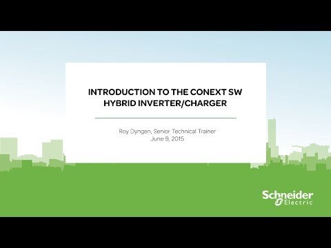

Schneider new SW webinar enjoy
new2PV
Solar Expert Posts: 305 ✭✭
HI this just got uploaded today...very informative enjoy..
[video]
https://youtu.be/VlO1QwEh93A[/video]
[video]
https://youtu.be/VlO1QwEh93A[/video] XW6848 inverter with 2 X mppt 60 150 CC , with Canadian solar 260Watt panels 2 x 3.5 kw array
