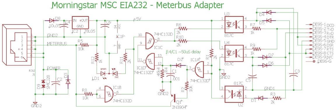

Dragging this from the dead only because I found it while searching for a Meterbus interface circuit. Never did find one, but did end up getting an MSC and reverse engineered it. It is NOT RS-485. It's basically a TTL level, open collector, bidirectional bus. Here it is. Should be right, but no guarantees.

I know this is an old topic, but has anyone been able to figure out the Meterbus physical link + protocol, so that an ESP32 dev board can be connected to a SunSaver MPPT via RJ11 directly, without the need for the PC Meterbus Adapter?
It's basically half duplex, 9600 bps Modbus RTU, using open collector drivers. The ModbusMaster library works with it.
I have tried connecting a generic RS485 to USB adapter to it (via an RJ-12 pigtail), and using a PC to send commands to it using modbus-cli, but none of the commands I sent returned any responses, so I'm wondering if it's some other protocol
It's Modbus, but nothing to do with RS-485, which defines the electrical signals.
I guess I'm trying to determine the electrical signals that Meterbus uses, so I can read and write the data
After further research I found that Meterbus uses a single wire for RX/TX (based on a diagram in the PC Meterbus Adapter manual: https://www.morningstarcorp.com/wp-content/uploads/operation-manual-pc-meterbus-adapter-en.pdf). That wire has 7V when measured with a voltmeter (I have not yet tried an oscilloscope).
I'm wondering if there's an industry standard physical link that Meterbus uses? -
As I already said, it uses an open-collector (aka open-drain) bus. Much like I2C, except it "talks" 9600 bps, half duplex, Modbus.
