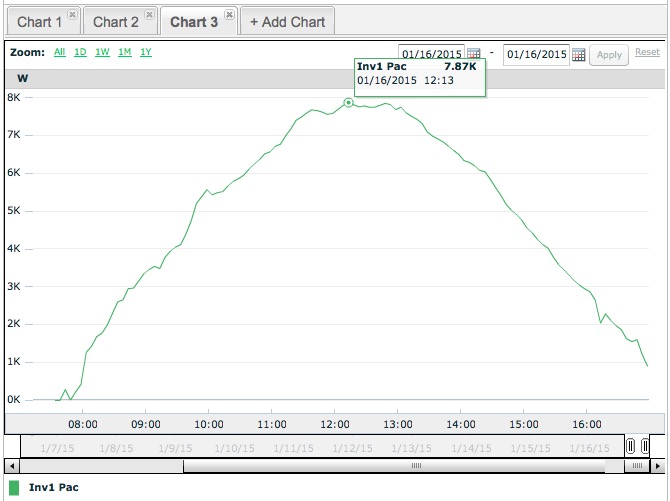

Had the first full sunny day with zero cloud cover today, pumped out 47.88kWh which is a bit on the low side for a 12.4kW system but expected due to shading issues from a neighbor's house.
You can see the effect of shading on the panels all along the bottom row. Unshaded those panels would have produced around 1.6kWh each but due to shading, they range from 72Wh to 1.39kWh. Sucks but again, expected and it's only in the winter months...past March they will all produce equal power.
There's also some other cool stuff available to view in the SolarEdge monitoring...
Max AC current for the day was at 33.08A
Max AC Energy
Max AC Power
Max AC Energy
Max AC Power
Re: First full day of sunny solar production...
AC voltage was steady all day around 244VAC
And DC voltage is regulated around 370VDC by the inverter, with a spike to 392VDC at the start of the day to "wake up" the inverter.
