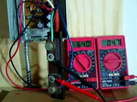

Meter readings, amps and volts and more info:
http://www.youtube.com/watch?v=hPtVGMifewM

What is the the controller doing in this setup? It does not look like it has enough parts (i.e., good sized inductor, FETs may be on the rear of the heat sink where I cannot see them--but could have voltage isolation issues) for actual MPPT tracking? Is it a buck or boost mode controller? I could see using switched capacitors to double output voltage (and no inductors)--but that is not really MPPT as I would understand it.
Also, what is the maximum input rating? You said 48 VDC (minimum?) and running a 240 VAC heating element on 48 volts will only run at about 4% of rated power (i.e., 2kW element will run at ~80 watts). You would need to run at ~333 watts for six hours to meet the 2kWH per day power generation you mentioned (or a 12 kW @ 240 VAC element and a 48 VDC Vmp-array).

Re: Solar Hybrid Hot Water using PV & ASHP !!Also, what is the maximum input rating? You said 48 VDC (minimum?) and running a 240 VAC heating element on 48 volts will only run at about 4% of rated power (i.e., 2kW element will run at ~80 watts). You would need to run at ~333 watts for six hours to meet the 2kWH per day power generation you mentioned (or a 12 kW @ 240 VAC element and a 48 VDC Vmp-array).
I'm also having a hard time seeing how this could generate meaningful heating. 330 watts (which is the derated, expected output of the suggested 2 220 watt panels in full sun) is only delivering about 1100 btus. In an hour, or even five, that's barely going to make a dent in the temperature a 40 gallon tank, especially if cold line or well water is coming in. It's something, but not much. And that's on a sunny day.
If possible, could the OP show a video with a multimeter displaying the input voltage at the heater element while the system is working? -

Re: Solar Hybrid Hot Water Controller For Your Hot Water Heater
Thanks for all your comments and interest in the Solar Hybrid Hot Water Controller.
I can see why there may be some confusion. A "48V" Panel set like mine, using "12V" panels, will generally MPPT at about 65V to 70V and is around 80V open circuit.
The MPPT tries to get the most it can out of the panels, and it's pulsing so the voltage can go higher during the off period and then come down under load for that short period, so it all works out pretty well as the MPPT works it's magic.
Of course the higher voltage you go the better, but dedicating a simple, cheap two 24V panel set to your water heater is good for most people and cost effective.
The idea isn't perfection, it's how simple and hassle free can it be, and in the end does your upper element come on less for a total installed system cost around $700 ?
That beats most of the other systems out there. All DIY, easy install with no plumbing nightmare, no soldering, no leaks and no worry of freezing. Almost anyone can wire up 2 wires.
The unit can handle 250V max and higher voltage is better of course, but you have to look at the cost factors of buying more panels to get the voltage up. I think the best cost/space/install trade-off for most people is dedicating two "24V" panels to this, also taking into considering things like roof space and at some point your thermostat will start turning off with higher power input and that would throw away perfectly good solar power.
I posted a video of meter readings and other info with a "48V" panel setup that may clear things up:http://www.youtube.com/watch?v=hPtVGMifewM -
