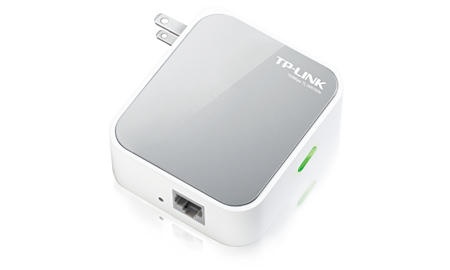

I then added a WiFi client device to bridge it into to my wireless network. I used one of these in client mode to make the connection. Definitely find a clean circuit in the house and don't plug the gateway into a plug strip. I just didn't want to fish Cat 5 all the way to my router to make the connection which was about 75 to 100 ft away.
http://www.tp-link.com/en/products/details/?categoryid=241&model=TL-WR700N
If you go that route, make sure you flash both the TED and the wireless bridge with the latest firmware while they are attached to a hard wire Ethernet connection. The cost of the wireless bridge was about the same as a long pre-made cat 5 cable. It was about $25 delivered if I remember correctly.
BTW the TED gateway is only a 10 mbit device, some routers/switches won't like the obsolete speed. Some actually have to step every thing on the device back to that speed. The TP-Link didn't seem to mind that speed. YMMV.
