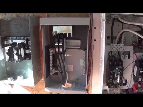

This is the array. I think there's a shut off switch in that box that someone flipped after the fire. I believe you are right Photowhit, those connectors look like the MC4 in the video. (Thanks for that link!) So if I cut the wire in the right place, does the electric flow stop because it's only flowing one way. (From the panel I removed to the box basically?)
