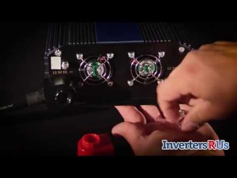

    I never said anything about a Grid Tie Inverter. I am looking for something similiar to this. https://www.youtube.com/watch?v=OQngNOgP5Lg. Except it must be 24v and Pure Sine Wave

    Why cant anyone listen to what i am saying. I AM NOT TALKING ABOUT A PLUG AND PLAY GRID TIE INVERTER. I AM TALKING ABOUT A INVERTER/CHARGER. Just look at video i posted earlier. Front of inverter shows a power cord that goes to a household plug. Turn the switch to on position to charge the batteries.That is used to charge the batteries. Back of inverter shows where you connect to the back of inverter to the batteries. Turn switch on and you have 110 power. Just watch the video and hopefully you will understand what i am looking for.
