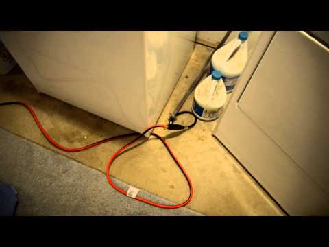

Bill I happened to stumble on this video which shows somebody that did pretty much what I had planned to do with the exception that he's using his car to power the inverter instead of a battery bank and his inverter does not have GFCI outlets.
Is this completely wrong to do even though he's using that main breaker interlock to prevent backfeeding into the grid?

I should correct myself... Yes, you can easily connect 120 VAC across the Blk+Red behind a (as in the above example) a drier double pole breaker. That would do it "automatically" and is exactly what I did with one of the external breaker setups wired back into my home panel (120 VAC genset and 120/240 VAC main panel).
What he did with the drier cord is called (in slang) a "suicide plug" -- the plug is "hot" from the AC inverter.
Will it work, yes. Did he do it, yes. Is it legal, no. Is there the possibility of issues (somebody turns on main breaker while AC inverter is plugged in and/or running?), yes.
Can it be done for a one time emergency (keep your family warm, pipes from freezing, etc.), yes. Should you make long term plans doing this--Not a great idea. Get the external breaker panel or build out a real sub panel--Highly recommended.
