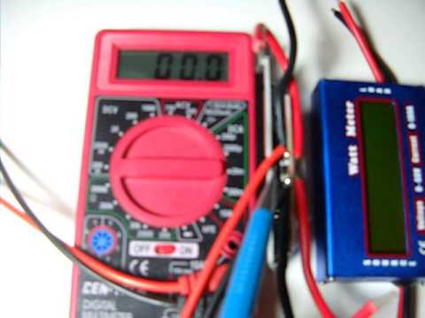

Does anybody else have one of these in use. I have 3 of them that have been kicking around for a while. They don't have any instructions and all the overseas venders are of no help. There are a red and black wires for line and load and a small port. I have seen these pictured in a discussion here in the past. Seems the port would accept a modular plug wired to a shunt maybe, but they aren't sold with any such modular plug nor instructions.
Found this youtube, it appears to have a 100 amp shunt built in.
https://www.youtube.com/watch?v=LUuPvfDmSZM

If it is similar to others, it is not rated for 100 AMPs continuous.
http://www.rc-cars-planes.com/docs/wu100v2_user_manual.pdf

I would suggest that most of these types of devices are way over spec'ed... 100 Amps for a second? Probably closer to 15-20 amps max continuous (from the typical wiring size).
-Bill
I made the connection between CC, (source) and Battery (load) trying to measure charging of my battery and the unit wouldn't even light up. Maybe this is a bad unit.
At least I have found out the port is for aux. power when measuring small voltage sources.2.1 Kw Suntech 175 mono, Classic 200, Trace SW 4024 ( 15 years old but brand new out of sealed factory box Jan. 2015), Bogart Tri-metric, 460 Ah. 24 volt LiFePo4 battery bank. Plenty of Baja Sea of Cortez sunshine.
