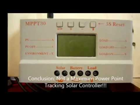

    Maybe I missed it, but I didn't see anyone state the obvious.
    Just about every one of those Chinese "MPPT" charge controllers aren't.  A true MPPT charge controller has large transformers and requires good sized heatsinks.  If an ebay charge controller is smaller than three decks of cards,... there's your answer.
    If someone needs further proof they can go to youtube and watch about a dozen videos of people debunking them as such.
    Now, with that said, I bought one of these knowing that it wasn't a true MPPT, and I'm still using it almost two years later.
    One of the guys on youtube showed that it wasn't a true MPPT, but in his testing he did find that it made a pretty d*** good PWM charge controller on 12v systems.  However, he found a much larger difference in performance when tested in a 24v system.
     I don't stress my 12 volt system very much, so I figured it was worth $30 to give it a try.   Granted, I watched the it like a Hawk for the first month.  Gradually, I came to trust the thing.  To this day I don't hook up anything to the 12 volt load output.  I use it strictly as a charger.
    That is how each one of these Chinese "MPPT" charge controllers should be handled.  Individually.  Just because one of a certain make/style worked for one guy doesn't mean the next one was assembled properly.
    When I finally change charge controllers I'll buy one of known better quality.  I consider two+ years of use a pretty good $30 spent.  However, it wasn't worth the stress I went through until I had faith in it.
    Resbum
    This is the one I bought.
    http://www.ebay.com/itm/LCD-10A-20A-30A-MPPT-Solar-Panel-Battery-Regulator-Charge-Controller-12V-24V-KJ-/181361857863
    I think this is the video I watched before deciding to give it a try.  He has some interesting efficiency results at the end of the video to pause and look at
    https://www.youtube.com/watch?v=tbmaG4f8f_w
