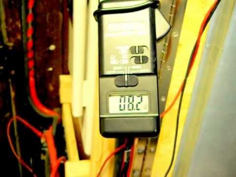

I installed 2- 1500 watt Missouri junk turbines on a 24VDC Buss back in November. Also 2- Outback Grid Tie 2435's or is it 3524? Whatever. We had allot more wind then, and I was greatly disappointed. I couldn't get more than 4 amps in 20 MPH winds.
30 days later I replaced them with 2-500 watt Thermodyne units. http://www.hydrogenappliances.com/ That was done between Xmas and New Year. The next heavy winds we got I registered a vast improvement. The winds logged the day I did the video were only 12.5 gusts.
Here's the video.
And for the next few weeks it continued to be successful. I realize it's not allot, but the breaking point for dramatic output is around 13 to 14 MPH winds. But compared to what I was getting, it was a vast improvement.
Since then, I have added 2 more 500 watt gensets. I learned allot from this, and it's hard to describe it all.
Here's the video on the doubles. It explains it all
