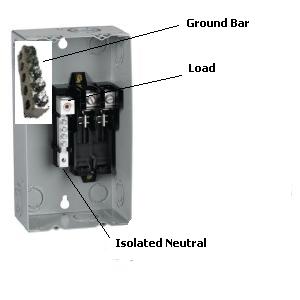

    So if my cabins load center looks like this inside..
    6 circuit and floating neutral.. (ground block off to the side not in picture)..
    I would do the load (black) to the back bone.. and neutral (white) to the floating (on plastic) neutral bar.. and the ground to the ground bar which is flat on the metal casing (not shown in pic)..?? (this would be with 14/3 wire to a 5-20 type plug that would plug into the inverter front socket..)
    and as long as all my outlets are wire LIKE THIS (all separate) I should be fine and not have to remove the GFI outlet??
    Keep in mind I am offgrid and this in effect is my LOAD panel... nothing coming in from ANY grid..
    Granted the OP in this post is apparantly similar but has a generator and Xfer switch.. so what ever you tell me to do may not apply to his issue..

    I would use NEUTRAL/W and LOAD/B wires to the panel from the inverter GFI outlet.. and ground the inverter separate from the load panel ground (as that is the AC ground as well as DC ground for the inverter).. that sound about right??
    The panel would have its own ground stake also..

    Are you suggesting to float the inverter/panel ground from the rest of the system? If so I would have safety concerns with this. What if there was a fault and someone got across both grounds? What if rain/moisture got on the panels or inverter, forms a ground and the GFI trips? What if there was a current leak in the inverter and the case becomes hot?
    The GFI would be operating the same as a 2 wire GFI and just detecting a mismatch between hot and neutral. It would not be able to detect a potential neutral to ground problem (if the GFI is of that type).

    If you're going to switch loads between two sources, each of which have a neutral-ground bond, you need need to switch all three: hot, neutral, and ground.
    The other choice is to remove the neutral-ground bond from both sources (including the one inside the inverter) and place it at the load distribution point only.
    Either of these will remove the scenario where there are two neutral-ground bonds allowing a path around the neutral detection side of the GFI that causes the tripping.

    Merely changing the outlet may not be enough if the internal neutral-ground bond is not actually on the outlet.
    Keep in mind these inverters with built-in outlets are meant to be "end use", not wire to an AC distribution system. In their intended application they work fine. The problem arises when they are connected to a system that has its one N-G bond, which creates the dreaded ground loop.
    So if my new install of outlets and 'panel' has NONE then I should technically be fine and GTG.. and it will all fall on the GFI of the inverter correct.. like a big 'outlet strip' basically.
    Yes. The only problem then would be if you have a secondary power input: it will have no N-G bond. You can't use the one in the inverter (by switching only the hot) because the neutral line will go through the GFI. Guess what can happen then? Yep; some current can flow through that, trip the GFI, and disconnect the loads from the N-G bond inside the inverter.
    Bit of a pain in the anatomy.
    No secondary input possible on this system.. just the PV array, battery bank, and inverter.. thats it for my cabin..
    I just want a 'panel' to bring all the outlets together neatly and somewhat proper looking.. vs have extension cords across the entire shed/cabin.. Going to put 2- 15 amp breakers in a mini 30 amp box and run a few circuits.. never draw more than the max anyway..
    I'll put a note on the panel.. no secondary power source to be used on this system..
